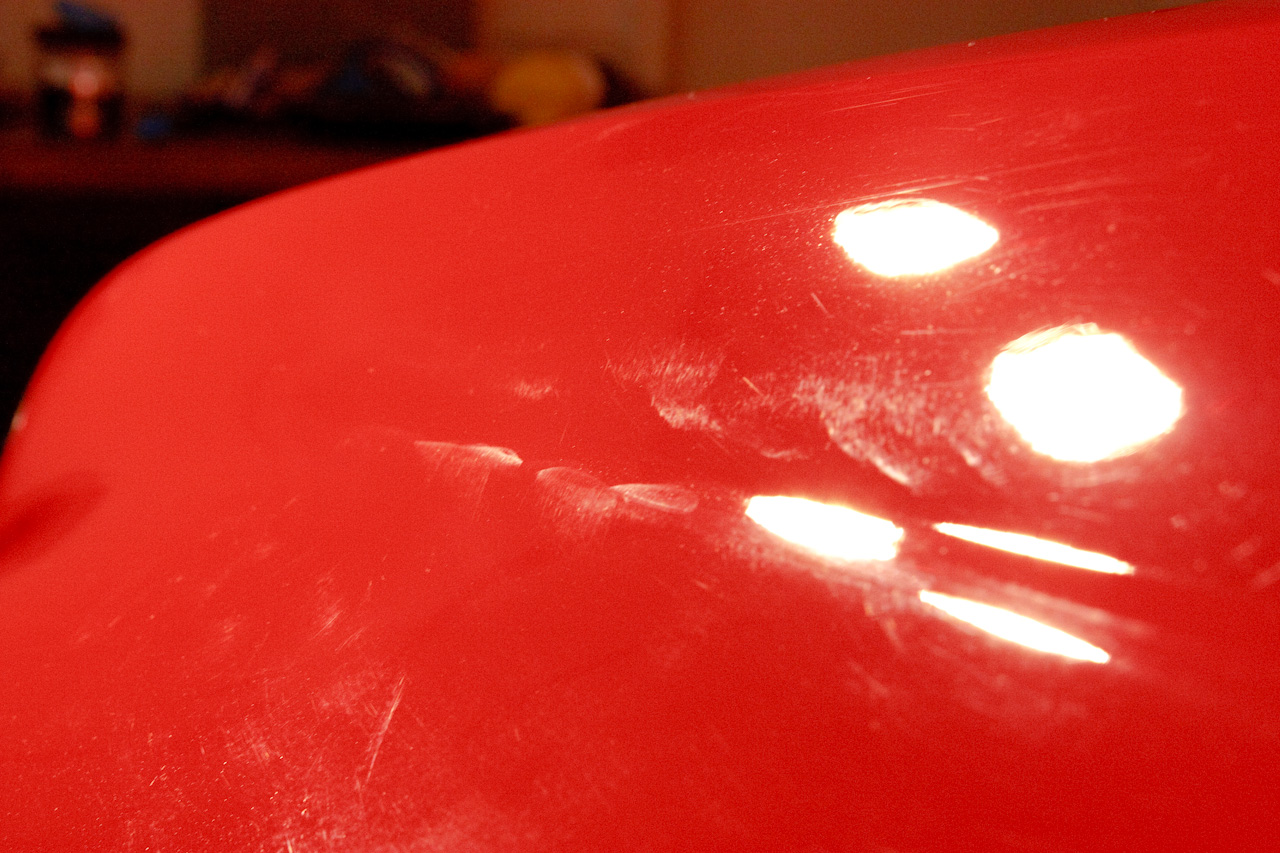

So I'm claying my 2009 G8 GXP which, unfortuantely, has a really soft clear coat. Using the baggie that one of my polishing pads came in, I can run my hand over parts of it and it feels like sandpaper. The car is three months old.
This is not a good sign.
So! Time to clay it.
Problem.
Claying it with an Adams Clay Bar leaves the paint looking like this:
It's... pretty heavily scratched. Polishing is now a must. Thankfully, I DO have the D/A Polisher Kit.
Any suggestions, though, to reduce the scratching? I'm using Adams Detail Spray, and I'm pretty sure I'm using enough. Should I knead the clay FAR more frequently, to make sure I'm not sanding the paint with the bar?
Thanks for any tips.

I would say that the scratches were already there, you can see them better now that you clayed and cleaned the surface! Not to worry they will come out.:2thumbs:
Problem is that they match pretty closely with the motions I was making with the clay. I'm literally in the process of doing all this right now. At 9:30 at night. I'm smart!
I'm continuing, but using more detail spray. It seems to help. *nods*

Well, thanks all for the tips. In the end, I have good news and bad news.
First, the bad news. I didn't have time to hit the car again with the Fine Machine Polish and then the superwax. So, unfortunately, all it's got at the moment is a wash, clay, and then FMP/SHR mixed polish job.
The good news? It looks GOOD. I used VRT on the tires, buffed the polish off with the super plush towel, and then went the extra mile afterward and used the leather conditioner to treat the interior. The car looks ... amazing.
Pictures!
Obviously there's still some spots I will, unfortunately, have to go back and hit later. The swirls are gone, but there are some deeper scratches remaining here and there that could use the attention. It still looks better now, though, than it has since I first brought it home.

Have you felt the paint with a plastic baggie after the clay job? If it is still gritty, I would opt to clay again. (I know that sucks, but will be well worth it). For you scratches, I would say that not enough lube was used and the clay 'dragged' or you might have had some grit in the clay. This happened to me once, (before I came to see the Adam's light) clayed the car with dirty clay and installed some nice scratch marks. Lesson learned. Clay is cheap, so I always use a fresh piece. I leave the old ones for rims, glass, tailpipes.
To polish, I would do SHR on a orange pad primed with detail spray. Watch Junkmans 'Slow Cut' video. Good stuff there for soft clear. I would then follow with FMP on a dry white. Perhaps two passes. If you really seem motivated, perhaps some revive. Then give it the SMW, followed by Americanna 12 hours later. 2x coats.
